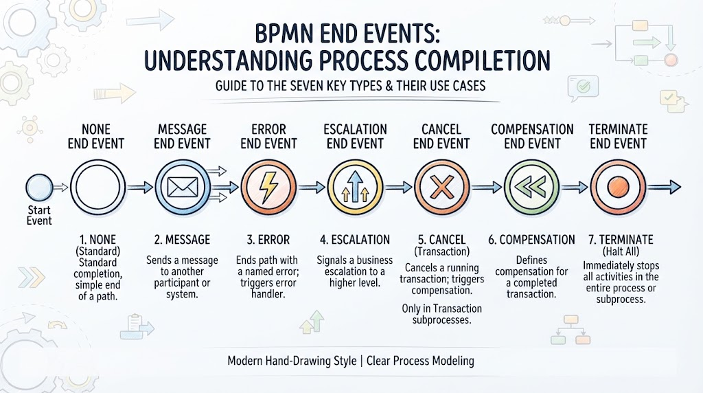

BPMN end event types infographic showing seven key variations: None, Message, Error, Escalation, Cancel, Compensation, and Terminate.
Key Concepts: The 7 Types of End Events
As illustrated in standard BPMN notation, End Events are depicted as circles with a thick border. The icon inside the circle determines the “Result”—the specific circumstance under which the process ends.
1. None End Event
  • Symbol: A thick circle with no inner icon.
  • Definition: This is the most common end event. It indicates that the process (or a specific path within it) has completed successfully without triggering any additional results.
  • Use Case: Standard process completion where no further action (like sending a message or throwing an error) is required.
2. Message End Event
  • Symbol: A thick circle with an envelope icon.
  • Definition: Indicates that upon reaching this point, a message is sent to another participant (usually in a different Pool).
  • Use Case: Completing an order and automatically sending a confirmation email to a customer or a notification to a partner system.
3. Error End Event
  • Symbol: A thick circle with a lightning bolt/bolt icon.
  • Definition: Indicates that the process has ended due to a specific business error or exception. This event “throws” an error that can be caught by an Error Boundary Event or an Error Start Event in a sub-process.
  • Use Case: A loan application is rejected due to insufficient credit score, triggering an exception flow rather than a standard approval flow.
4. Compensation End Event
  • Symbol: A thick circle with a rewind/undo icon.
  • Definition: Triggers compensation logic. It does not end the process immediately but signals that previous activities need to be “undone” or compensated for.
  • Use Case: A flight booking is confirmed, but the hotel reservation fails. The Compensation End Event triggers a task to cancel the flight booking to maintain data consistency.
5. Link End Event
  • Symbol: A thick circle with a right-pointing arrow.
  • Definition: Connects two points on the same page to avoid long, crossing sequence flows. Note: As mentioned in your source material, this is often considered a legacy element and may be replaced by Signal events in future BPMN versions.
  • Use Case: Connecting the end of a complex validation sequence on the left side of a diagram to a continuation point on the right side, keeping the diagram clean.
6. Terminate End Event
  • Symbol: A thick circle with a solid black dot.
  • Definition: This is the “hard stop.” When a token reaches a Terminate End Event, it immediately stops all execution within the current process instance, including any parallel paths that might still be active.
  • Use Case: A “Cancel Order” button is pressed. Regardless of whether the payment is processing or the warehouse is packing, the Terminate End Event kills the entire instance immediately.
7. Multiple End Event
  • Symbol: A thick circle with an asterisk/star icon.
  • Definition: Indicates that the process can end in one of several ways, or that multiple results occur simultaneously.
  • Use Case: A recruitment process ends when either a candidate is hired (Message) or the position is closed (None), depending on runtime conditions.

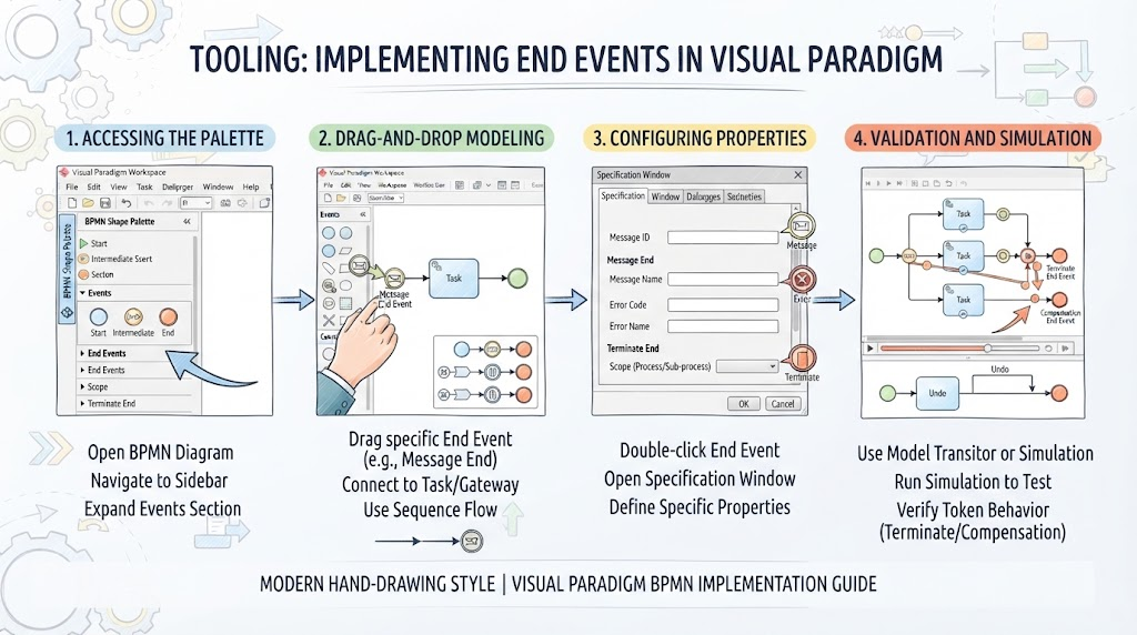

Tooling: Implementing End Events in Visual Paradigm
Visual Paradigm is a robust tool for creating BPMN diagrams. Here is how to effectively use these concepts within the software:
Tooling: Implementation End Event in Visual Paradigm
1. Accessing the Palette
  • Open your BPMN diagram in Visual Paradigm.
  • Navigate to the BPMN Shape Palette (usually on the left sidebar).
  • Expand the Events section. You will see categories for Start, Intermediate, and End events.
2. Drag-and-Drop Modeling
  • Simply drag the specific End Event shape (e.g., Message End Event) onto the canvas.
  • Connect it to the preceding Task or Gateway using a Sequence Flow (solid line with arrow).
3. Configuring Properties
  • Double-click the End Event to open the Specification Window.
  • For Message Events: You can define the specific Message ID and Name to ensure it links correctly to a Message Start Event in another pool.
  • For Error Events: Define the Error Code and Error Name. This is crucial for ensuring the corresponding Error Boundary Event catches the correct exception.
  • For Terminate Events: Visual Paradigm allows you to set the scope (Process vs. Sub-process) to ensure you don’t accidentally terminate a parent process when you only meant to stop a sub-flow.
4. Validation and Simulation
  • Use the BPMN Model Transitor or Process Simulation features in Visual Paradigm to test your End Events.
  • Run a simulation to verify that a Terminate End Event actually kills parallel tokens as expected, or that a Compensation End Event correctly triggers the undo tasks.
