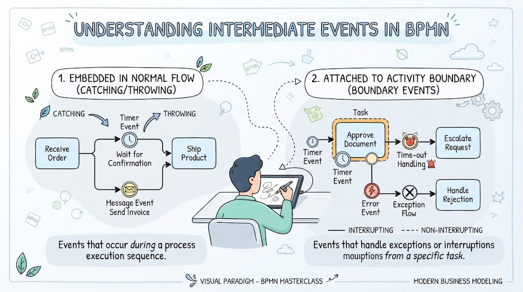

1. What Are Intermediate Events?
Intermediate events are circular symbols placed between the start and end of a process. Unlike start events (which trigger a process) or end events (which conclude it), intermediate events represent occurrences that take place during the execution of a process. They are visually distinguished by a double thin border around the circle, differentiating them from single-bordered start/end events.

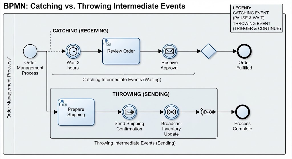

There are two fundamental orientations:
  • Catching (Receiving) Intermediate Events: The process pauses and waits for something to occur before continuing. Examples include waiting for a message, a timer expiring, or a signal being broadcast.
  • Throwing (Sending) Intermediate Events: The process actively generates or triggers something and then continues. Examples include sending a message, emitting a signal, or logging an escalation.

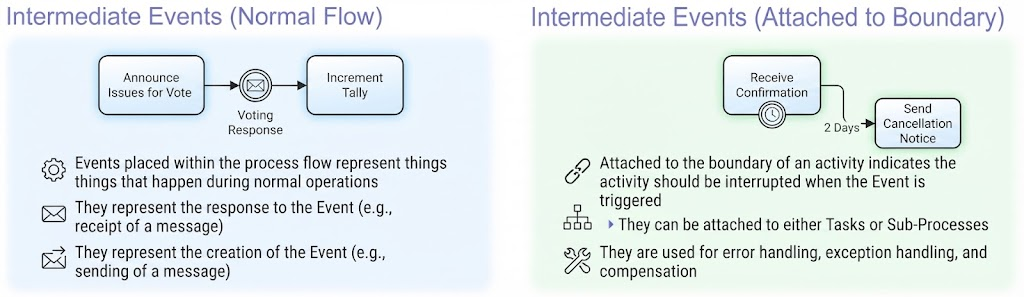

2. Intermediate Events in Normal Flow
When placed directly on the sequence flow between activities, intermediate events represent routine, expected occurrences within the standard path of a process. They are part of the “happy path” and do not interrupt or divert the flow—they simply mark a point where something must happen before the next task can proceed.

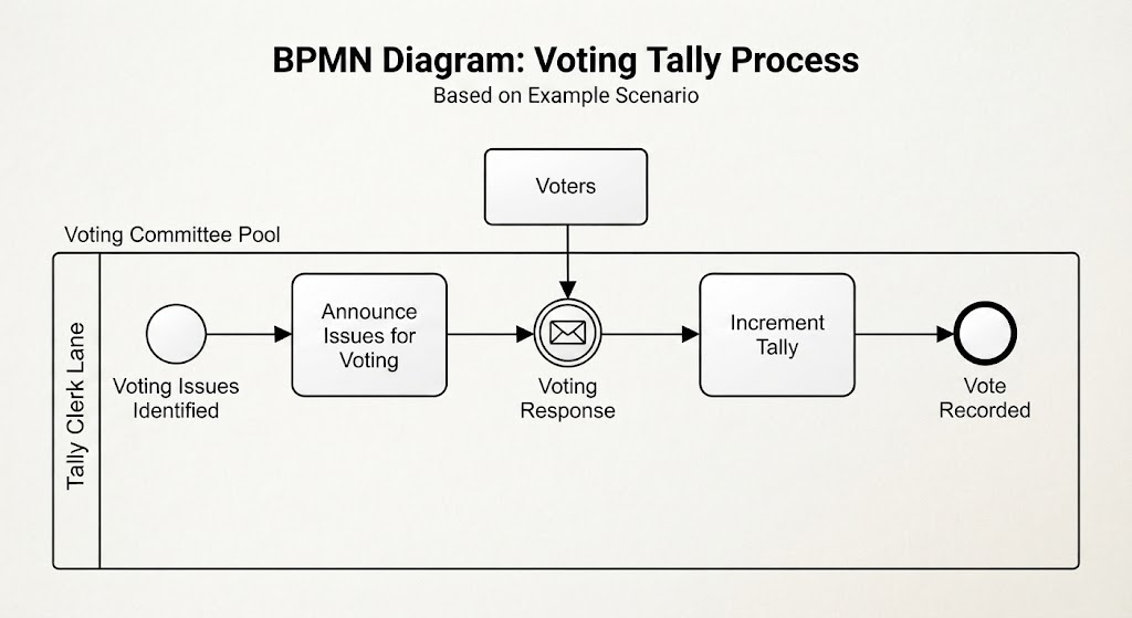

Example Scenario – Voting Tally Process:
A committee announces issues open for voting. The process then waits for individual voting responses to arrive (a catching message event labeled “Voting Response”). Once a vote is received, the tally is incremented. This is a textbook normal-flow intermediate event: the message receipt is an expected, integral part of the process, not an exception.

3. Intermediate Events Attached to Boundaries
Boundary intermediate events are attached to the edge of an activity (task or sub-process) rather than sitting on the sequence flow. Their purpose is fundamentally different: they define what happens when something unexpected or time-sensitive occurs while an activity is executing.

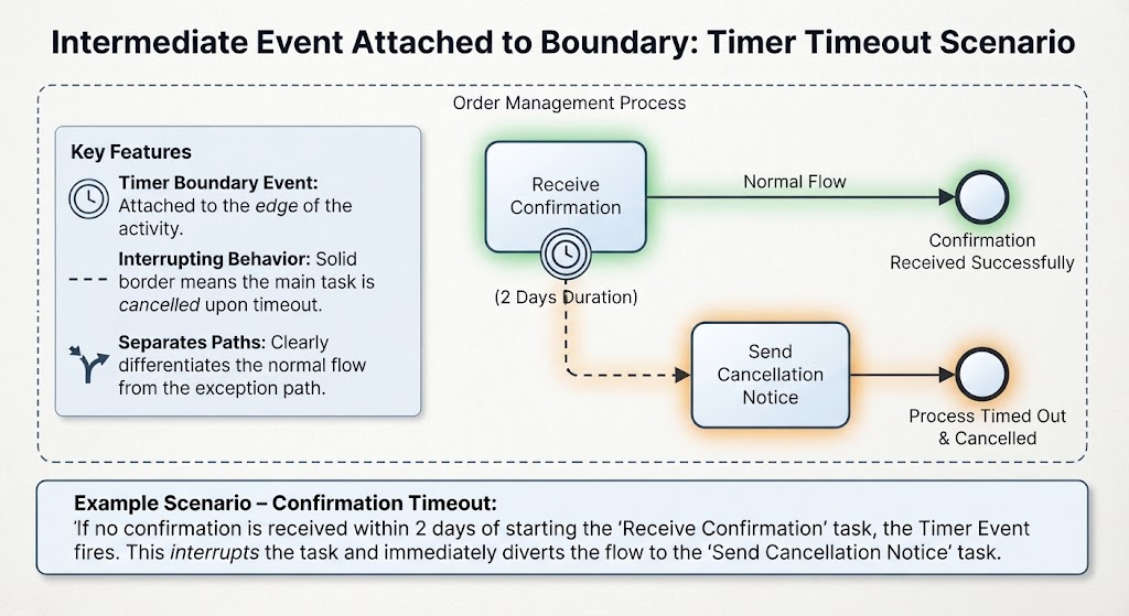

Example Scenario – Confirmation Timeout:
A process includes a “Receive Confirmation” task. A timer boundary event is attached with a 2-day duration. If the confirmation does not arrive within 2 days, the timer fires, interrupts the receive task, and diverts the flow to “Send Cancellation Notice.” This cleanly separates the normal path from the timeout exception path.

4. Catching vs. Throwing: A Quick Reference
Aspect Catching Event Throwing Event
Behavior Waits / Listens Sends / Triggers
Icon Fill Empty (white) Filled (solid)
Sequence Flow Incoming arrow enters; outgoing continues after trigger Outgoing arrow leaves immediately after trigger
Typical Use Receiving messages, waiting for timers Sending messages, emitting signals, escalating

Step-by-step: Voting Response Example
  1. Place a Task shape labeled “Announce Issues for Vote” on the canvas.
  2. From the palette, drag a Catching Message Intermediate Event (empty envelope icon) and place it to the right of the task.
  3. Use the Sequence Flow connector to draw an arrow from the task to the message event. Label this flow if desired (e.g., “Await Response”).
  4. Drag another Task shape labeled “Increment Tally” and connect it from the message event with a second sequence flow.
  5. Double-click the message event to open its specification dialog. Here you can define the message name, correlation keys, and whether the event is interrupting (for normal flow, it is inherently sequential, so this setting has limited impact).
  6. Optionally, add a Throwing Message Event after “Increment Tally” to model sending an acknowledgment back to the voter.

Step-by-step: Confirmation Timeout Example
  1. Place a Task shape labeled “Receive Confirmation” on the canvas.
  2. From the palette, select the Timer Boundary Event (clock icon). Hover over the “Receive Confirmation” task until attachment points appear on its border, then click the bottom edge to attach the timer.
  3. By default, Visual Paradigm attaches boundary events as interrupting (solid border). To make it non-interrupting, right-click the event and select “Toggle Interrupting”—the border will change to dashed.
  4. Draw a sequence flow from the timer event downward to a new Task labeled “Send Cancellation Notice.”
  5. Double-click the timer event to specify the time definition: choose between a specific date/time, a duration (e.g., “P2D” for 2 days in ISO 8601 format), or a cycle for recurring timers.
  6. The normal outgoing flow from “Receive Confirmation” (to the right) represents the successful path; the boundary flow (downward) represents the timeout exception path. Both coexist cleanly on the diagram.
