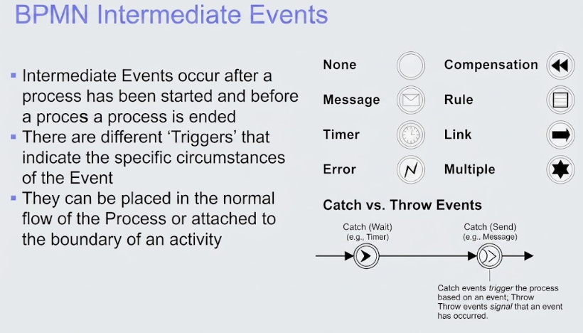

What Are Intermediate Events?
  • Definition: An Intermediate Event occurs after a process has started and before it ends. It represents a point in the flow where something happens that affects the continuation of the process.
  • Placement: They can be placed directly in the normal sequence flow (catching or throwing) or attached to the boundary of an activity (as a Boundary Event).
  • Triggers (Icons): Each event type is distinguished by a specific icon inside the double-bordered circle, indicating why the event fires.
Catching vs. Throwing
Type Description Example
Catching Waits for a condition to occur before continuing Waiting for customer approval email
Throwing Actively triggers/sends something and continues immediately Sending a notification, raising an error
The Eight Intermediate Event Types
  1. None – No specific trigger; used as a generic placeholder or for linking flows.
  2. Message – Catches or throws a message (e.g., email, API call).
  3. Timer – Triggers based on a date/time, duration, or cycle.
  4. Error – Catches or throws an error condition (typically used with Error End Events and Error Boundary Events).
  5. Compensation – Triggers undo/rollback logic when a prior activity needs to be compensated.
  6. Rule – Evaluates a business rule; proceeds based on the rule’s outcome.
  7. Link – Connects two points in the same process level without drawing a long sequence flow line (improves diagram readability).
  8. Multiple – Represents multiple possible triggers; the event fires when any (or all, depending on configuration) of the specified triggers occur.

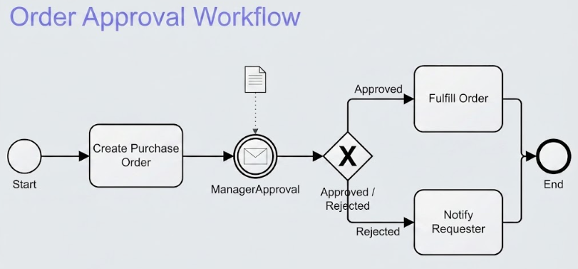

Example 1: Message Intermediate Event – Order Approval Workflow
Scenario: After a purchase order is created, the system must wait for manager approval via email before proceeding to fulfillment.
Model Elements:
  • Start Event → Task “Create Purchase Order” → Message Catch Event (wait for approval) → Gateway (approved/rejected) → Task “Fulfill Order” / Task “Notify Requester”
Visual Paradigm Steps:
  1. Open Visual Paradigm → Create a new BPMN Diagram.
  2. Drag a Start Event onto the canvas.
  3. Add a Task (“Create Purchase Order”) and connect it with a Sequence Flow.
  4. From the BPMN palette, drag an Intermediate Catch Event and place it on the flow.
  5. Right-click the event → Set Event Type → Select Message.
  6. In the Specification window, define the Message Name (e.g., ManagerApproval) and optionally link it to a Message artifact.
  7. Continue the flow with an Exclusive Gateway for the approve/reject decision.

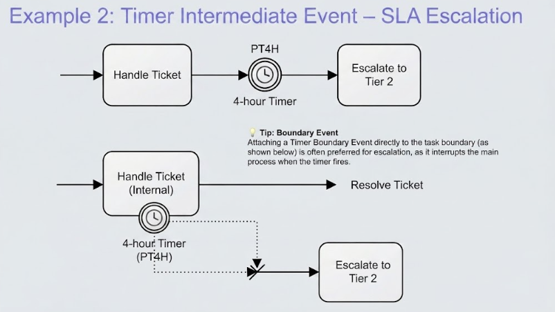

Example 2: Timer Intermediate Event – SLA Escalation
Scenario: If a support ticket is not resolved within 4 hours, automatically escalate it to Tier 2 support.
Model Elements:
  • Task “Handle Ticket” → Timer Intermediate Event (4-hour duration) → Task “Escalate to Tier 2”
  1. Place a Task (“Handle Ticket”) on the diagram.
  2. Add an Intermediate Catch Event after it.
  3. Set the event type to Timer.
  4. In the Timer specification, choose Duration and enter PT4H (ISO 8601 format for 4 hours).
  5. Connect the timer event to the “Escalate to Tier 2” task.
💡 Tip: You can also attach a Timer Boundary Event directly to the “Handle Ticket” task instead, which interrupts the task if the timer fires — this is often more semantically correct for escalation scenarios.

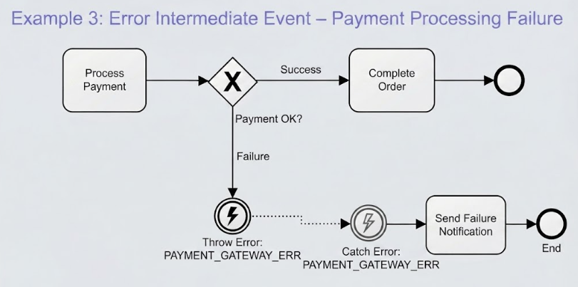

Example 3: Error Intermediate Event – Payment Processing Failure
Scenario: During payment processing, if the payment gateway returns an error, catch it and notify the customer rather than failing silently.
Model Elements:
  • Task “Process Payment” → Error Throw Event (on failure path) → Error Catch Event → Task “Send Failure Notification”
  1. Model the “Process Payment” task with an Exclusive Gateway for success/failure.
  2. On the failure branch, add an Intermediate Throw Event and set its type to Error.
  3. Define the Error Code (e.g., PAYMENT_GATEWAY_ERR) in the specification.
  4. Downstream, add an Error Catch Event that references the same error code.
  5. Connect it to the “Send Failure Notification” task.

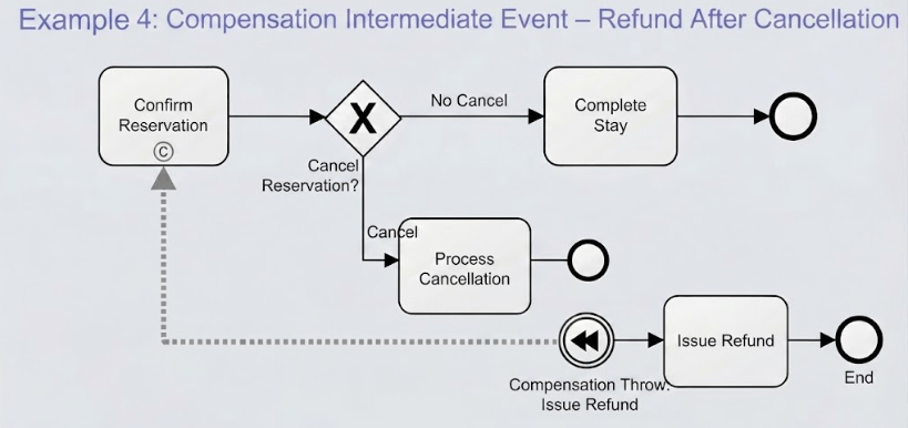

Example 4: Compensation Intermediate Event – Refund After Cancellation
Scenario: After a hotel reservation is confirmed, if the guest later cancels, the system must compensate by issuing a refund.
Model Elements:
  • Task “Confirm Reservation” (marked as compensable) → …later… → Compensation Throw Event → Task “Issue Refund”
  1. Select the “Confirm Reservation” task → In its properties, check Compensate to mark it as compensable.
  2. Later in the process (e.g., after a “Cancel Reservation” task), add an Intermediate Throw Event.
  3. Set the type to Compensation.
  4. Connect it to the “Issue Refund” task. Visual Paradigm will automatically associate it with the compensable activity.

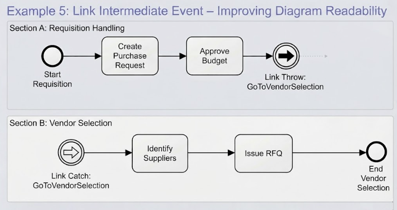

Example 5: Link Intermediate Event – Improving Diagram Readability
Scenario: A complex procurement process spans multiple pages or sections. Use Link events to avoid crossing lines.
Model Elements:
  • Link Throw Event at the end of Section A → Link Catch Event at the start of Section B (same name)
  1. At the point where you want to “jump,” add an Intermediate Throw Event and set type to Link.
  2. Give it a meaningful name (e.g., GoToVendorSelection).
  3. At the target location, add an Intermediate Catch Event with type Link and the same name.
  4. Visual Paradigm treats these as a logical connection without a visible sequence flow line.

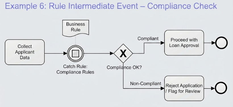

Example 6: Rule Intermediate Event – Compliance Check
Scenario: Before approving a loan, evaluate whether the applicant meets regulatory compliance rules.
Model Elements:
  • Task “Collect Applicant Data” → Rule Intermediate Event → Gateway (compliant/non-compliant)
  1. After the data collection task, add an Intermediate Catch Event.
  2. Set type to Rule.
  3. In the specification, reference the Business Rule artifact (created separately in Visual Paradigm’s Rule Modeler).
  4. Branch the flow based on the rule outcome.

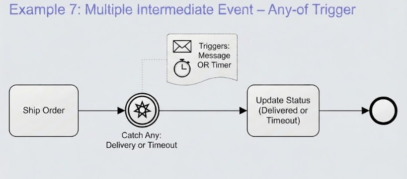

Example 7: Multiple Intermediate Event – Any-of Trigger
Scenario: A shipment tracking process should proceed when either a delivery confirmation message arrives or a 7-day timer expires (whichever comes first).
Model Elements:
  • Task “Ship Order” → Multiple Intermediate Catch Event (Message + Timer) → Task “Update Status”
  1. Add an Intermediate Catch Event after “Ship Order.”
  2. Set type to Multiple.
  3. In the specification, add both a Message trigger and a Timer trigger.
  4. Choose the behavior: Any (first to fire wins) or All (must wait for all).
